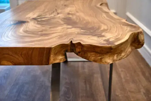

I had to google “Live Edge” and it is certainly an interesting design concept for table surfaces.

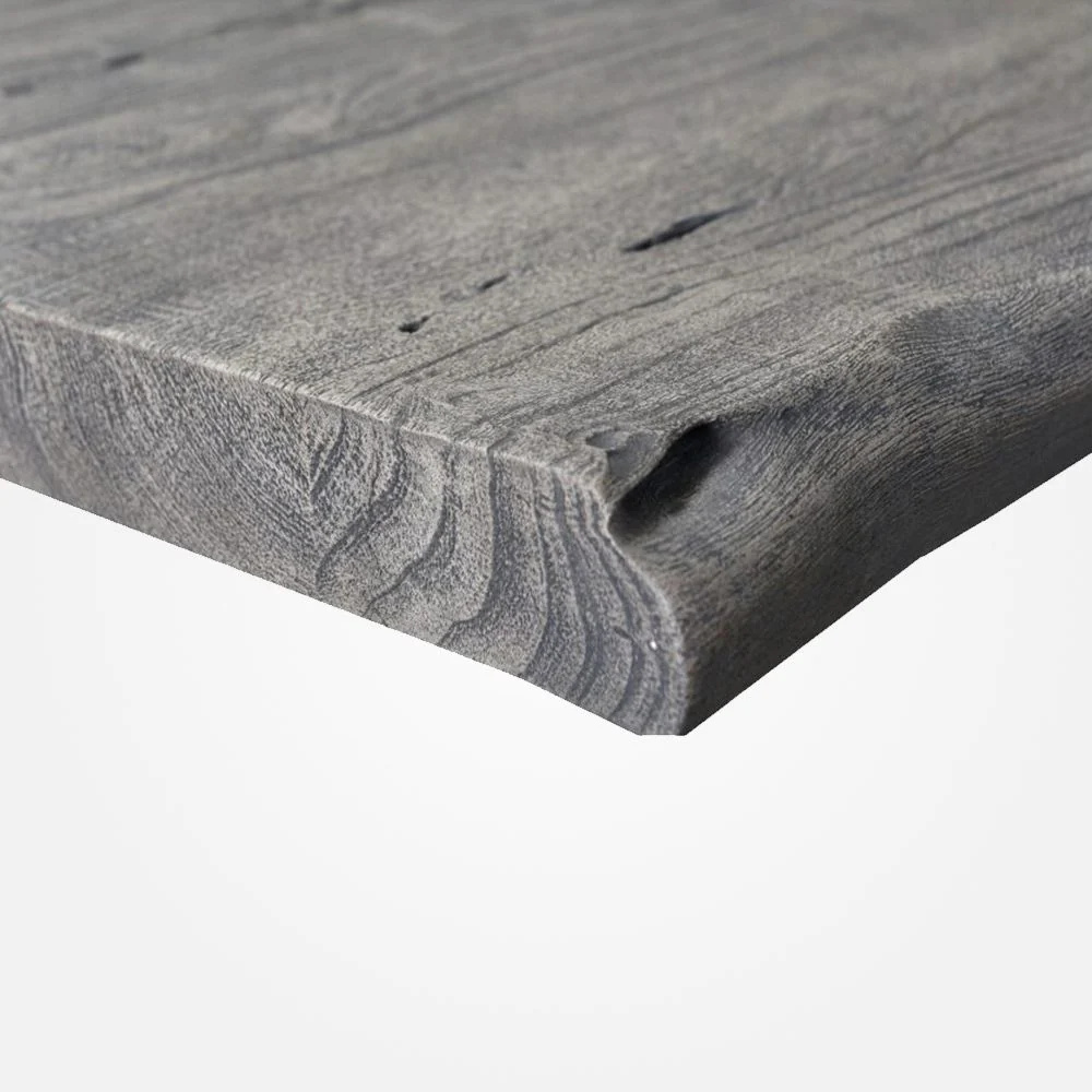

From the images I seen of Live Edge surfaces, I feel your model has top and bottom surfaces too perfectly parallel. From the examples I have seen, it is very rarely the case to have a perfect straight edge from the top to bottom surface following the organic natural curves of a tree.
I think also adding some parts that divot inwards on the sides would add some interest to the overall geometry. Also adding in imperfections to the surface I think would also help sell the render as well.

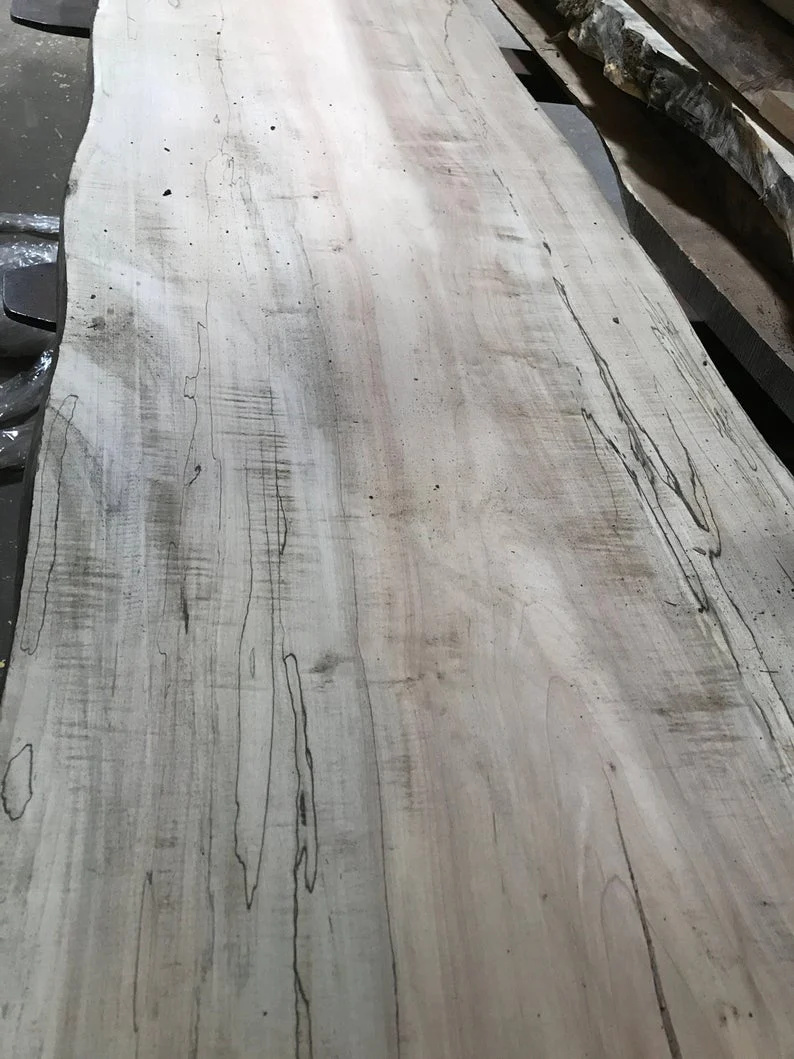

I think after splitting your surfaces, adding an outer tree texture would make it look like it was off an actual tree. Then the internal textures, I don’t believe the color is so uniform. Adding some different shades of grey would help sell the realism. Having such perfect color and lines makes it look more like laminate vs. actual wood.
